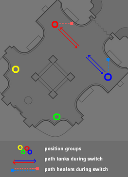

    The Four Horsemen are the third and final boss encounter in the Military Quarter.
    Easy 10-man Strategy
    Need: 2 tanks, 3 healers (tested with 3, probably 2 possible too), at least 1 caster dps, preferably with selfhealing ability's.
    Why / when to use: when your party dies from taking too much mark damage. This tactic will put less marks on the dps (@ switch from 3 to 3and1 instead of from 3 to 4and1) and migrate damage a bit more to the tanks (meteor, marks) instead of party, so in most cases it will become easier to heal. We got them down the first time using this tactic, after having problems with high raid damage.
    How it works:
    All 4 horsemen will run to a corner, where they need to be tanked. The key in this fight is that you need to switch tanking targets after each few marks, or the stacking damage from the marks gets too big. You need to split up raid into groups, and let them stick in a corner.
    Group yellow, west corner: healer
    Group green, south corner: ranged dps
    Group red, north corner: tank + healer
    Group blue, east corner: tank + healer + rest of dps
    When the encounter starts, all groups start getting aggro on the bosses in your corner. BLUE group go ALLOUT on Kor'Thazz, with skills, cooldowns, etc. he needs to be down fast because of the meteor. RED group just tank Rivendare and stay alive. YELLOW, tank the ranged boss in your corner, and heal yourself and green/rangedtank. GREEN, tank your ranged. (note that Blaumeux and Sir Zeliek cast-attack the closest target in range, so all yellow and green need to do is stay with boss and don’t die. Though ofc any dps is nice)
    Now comes the switch. At the moment the 3rd mark hits, YELLOW and GREEN need to switch. They do this simply by running to the others position, because the boss will target the closest person. Now they start to tank the other boss and stack 3 other marks. Switch again after 3. After the 3rd mark hits, the RED and BLUE tank move towards each other, so they can switch targets with taunt, before mark 4. Then move back to your old corner. Start dps/tanking/healing again. Switch every other 3 marks. Repeat till Kor is dead, then move to Riv, followed by Blau, then Zel. Congrats!
    Classnotes
    Tanks
    Remember to coordinate with the other tank, move to each other after mark 3, taunt quickly, move back fast. Don't forget that marks lower threat by 50%.
    Healers
    Yellow heal yourself and green. Red heal yourself and red tank. Blue heal yourself and blue tank and DPS (AoE heals).
    DPS rest
    Nuke Kor’Thazz, save skills and CDs for Rivendare. Don’t walk along with the tanks or you may get an extra mark.
